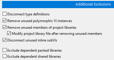

You may be able to set the vi properties in the build spec to enclude the FP as well... I can't check for sure via phone.
