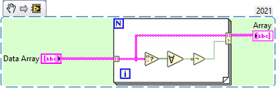

It's not possible to remove a single element from a 2D array: you need to remove either an entire row (like in your case) or an entire column.
So, check if a row is completely blank: if so, remove it from the output. Hereafter an example. Right-click on the output tunnel to set is Conditional.

Thank you for this. I was trying to iterate through each individual one. This works perfectly. Did not even think to do it this way.
(5,531 Views)
Yes, you can only remove entire rows, of course.
Yes, there are many ways to do this. Here's my variation. 😄 Same difference!
