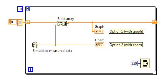

I have a programme i writting at the moment. I am using a for loop for taking measurements. Measurement are taken at specfiic intervals previsoly determined. At each interval the for loop runs takes a set of measurements and send them to 1D arrays on the front panel. I am using the tunnel mode feature of labview 2013 to concatenate the array.
The problem i am having is loop runs takes all the measurments concatenates them and once the loop has finished you can then see them on the front panel. If i want to see the measurements going into the array as they are taken how do i do this.
attached is a picture of the for loop

You can concatenate data in your loop by using "build array" function and displaying the resulting array in the graph.
Otherwise you can use a chart instead of a graph.
