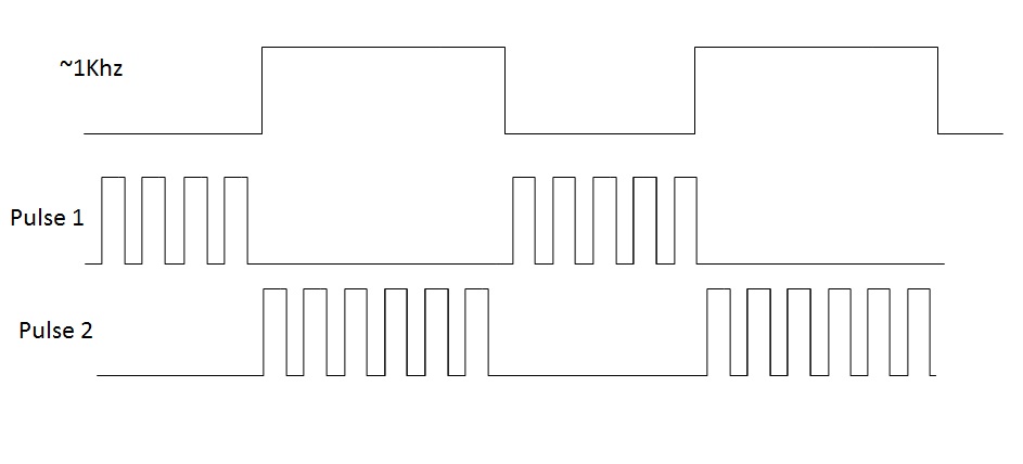

I am new to LabView, but looking at the examples, it seems to me that these solutions are not exactly what I need. The start and stop events there stop the acquisition/generation of the signal altoghether while I need the signals to be generated all the time with the switch between the two being of a certain high enough (say, 1Khz) frequency which is much lower than the frequency of the signals.
Here is what I mean: the 1Khz signal switches the faster train pulses on and off all the time.
