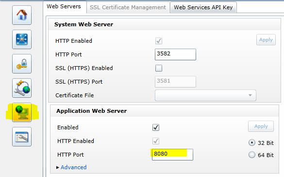

You can safely change the default port using the Web Server Configuration Page. The following whitepaper in the "Web Services Created by LabVIEW" section hints at the location: https://www.ni.com/en/support/security/configuring-software-and-hardware-firewalls-to-support-nation...
The whitepaper says http://<server ip address>:5353 for the Web Server configuration page but the following help topic now says http://<server ip address>:3582 to access the interface: https://www.ni.com/docs/en-US/bundle/labview/page/setting-up-the-application-web-server-for-web-serv...
Then on the Web Server Configuration tab you can set the port:
