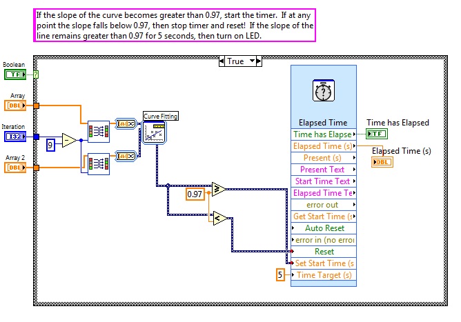

BillMe,
I have attached a picture of my program below.  The problem I am having now, is that the program says the target time has been reached when it clearly has not.  I have the target time set to 5 seconds, however it only reaches 3.4 seconds before it says that the time has been reached.  Any suggestions???

Ok, so first of all, how can you do a curve fit and then start a timer based on all the data points all at once? There has to be some time interval between points so the timer has a chance to reset and count down. What was the time period over which your data was acquired? I'm assuming it was many seconds. So you need a loop that iterates at that same sample rate.
Also, don't wire the "Set Start Time", that's not needed. You only need to toggle the RESET for your two cases of slope.
Is this the actual VI or is there stuff missing?

BillMe,
I output the slope from the curve fit.  This value updates with each iteration of a loop.  So whenever that slope becomes less than my constraint slope, the timer is reset.  I have allowed an accumulation of 20 data points for which I perform the initial linear fit on.  So it gets the slope of the initial fit and then performs a new fit for every new data point that is recorded.
