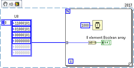

You could start with something simple like this. Use each bit in the U8 integer controls one LED. Pre-load the array of U8s to define the solenoid sequence.
 I didn't feel like waiting 5 minutes for the complete cycle, so I just have them changing once per second.

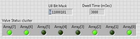

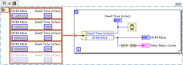

@Athakore wrote:
Hi
thank you for the response I wanted to ask how would you indicate which Boolean LED is the integer input in the U8. like how do I make the first Boolean led the first input into the array.
The first LED would be Bit 0 in the U8 and would correspond to the Solenoid Valve[0], the second LED would be bit 1 and Solenoid Valve[1], etc.
Many commercial switch matrices use this method (was assuming you would be trying to control real hardware and not just the front panel UI). If you use clusters then it would look something like this (I used msec instead of minutes for the dwell)

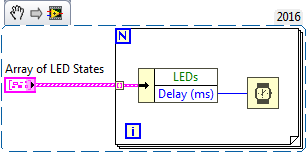

So here is a Cluster called LED State consisting of an Array of Boolean Controls (called LEDs) and a U32 called Delay (ms), as well as an Array called Array of LED States.
And here is how you might use this Array (I left out doing things with the Array of LEDs).
Bob Schor
