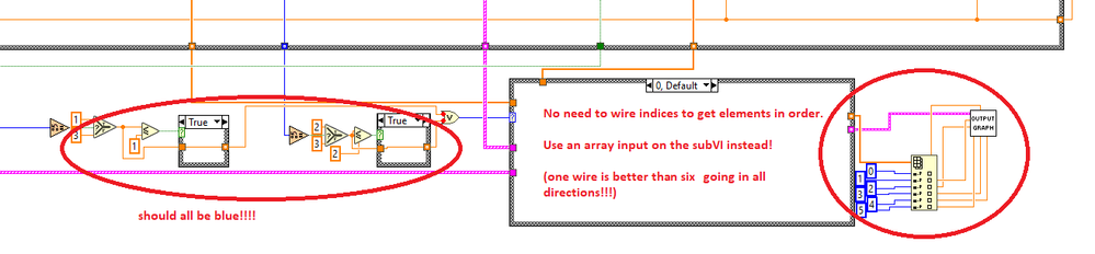

    In the images attached to this post, I have two main loops that run one after the other. I'd like to have one output window with a graph and data that updates with each iteration for both loops. The UpperandLower.png shows the two main loops. At the bottom of the image shows my attempt at selecting which data is written to the output window. THD data.PNG gives a better look at my data selection logic and the output window. I'm sure there's a much more straight-forward (and functional) way to do this, so I appreciate any feedback.

Your code is a prime example to implement a state machine instead. Your two loops are never active at the same time and contain mostly identical code, so all you really need is one loop and switch state accordingly.
It is hard to fully gauge the code from a truncated picture (we can't even see the toplevel loop!), but I think there are serious architectural problem and the the entire thing could be done with much less than half the code.
There are also other fundamental flaws, such as poor choice of datatype ((using orange for obvious integers and even doing bitwise operations on them!!! 😮 )
The circled code in the left is pure madness! It does not take two selects, two comparison, and two case structures to turn two booleans into a numeric!!!!!
I'd consider starting from scratch with a proper state machine and all your problems will disappear. good luck!

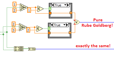

To turn two booleans into a 0..3 numeric, here's all you need.
(see also)

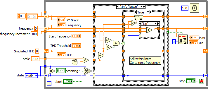

Simple enough! that code should fit on a postcard! You have three main states:
  1. Idle, where the user enters the desired limits. Go to next state if "Go!" has been pressed.
  2. scanning up from the middle, Go to next state if THD limit has been reached
  3. Scanning down from the middle. Go to idle state and wait for user input.

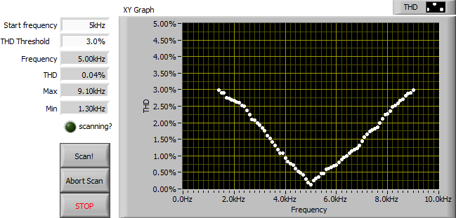

To give you some pointers, here's a quick demo for a state machine. Easily fits on a postcard. 😄
