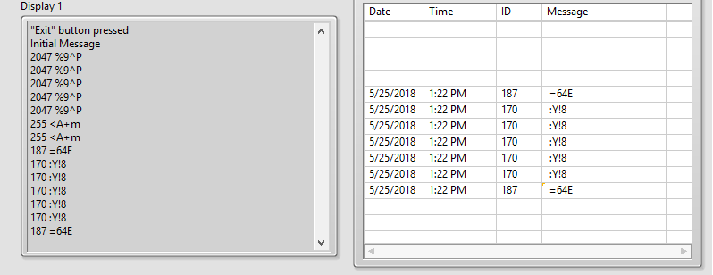

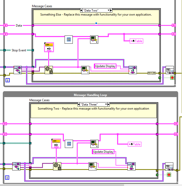

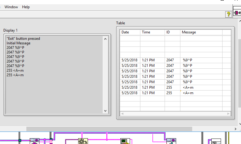

Not sure why this happens but when I run my program it overwrites what the first message handler loop writes with the messages that the second message handler loop writes. This project follows the same guidelines of the sample project in LabView for the message handler queue. Also I am not sure why the table starts to fill in at the fourth row if someone could answer that too. ThanksBlock Diagram.PNGBlock Diagram.PNGFirst Table (Front Panel).PNGFirst Table (Front Panel).PNGSecond Table (Front Panel).PNGSecond Table (Front Panel).PNG

Here's a question -- have you tried building a simpler QMH example, one with only a single Message Handler, say the top one (the middle loop)?  I would recommend getting something "simpler" to perform correctly before tackling a more complicated routine.  But let's assume that you did so.  Look at the bottom QMH loop.  Look at its Initialize step.  What happens next?  Do you see an "Oops!"?
I haven't looked at your output yet to examine why you have blank lines.  Does this happen in the "single QMH Loop" version?

I was able to fix the blank lines. I had the single MHL working so I tried to add another one but know having them output to the same table is an issue. I took out the contents of initialize that were not needed. The issue is still happening tho.
