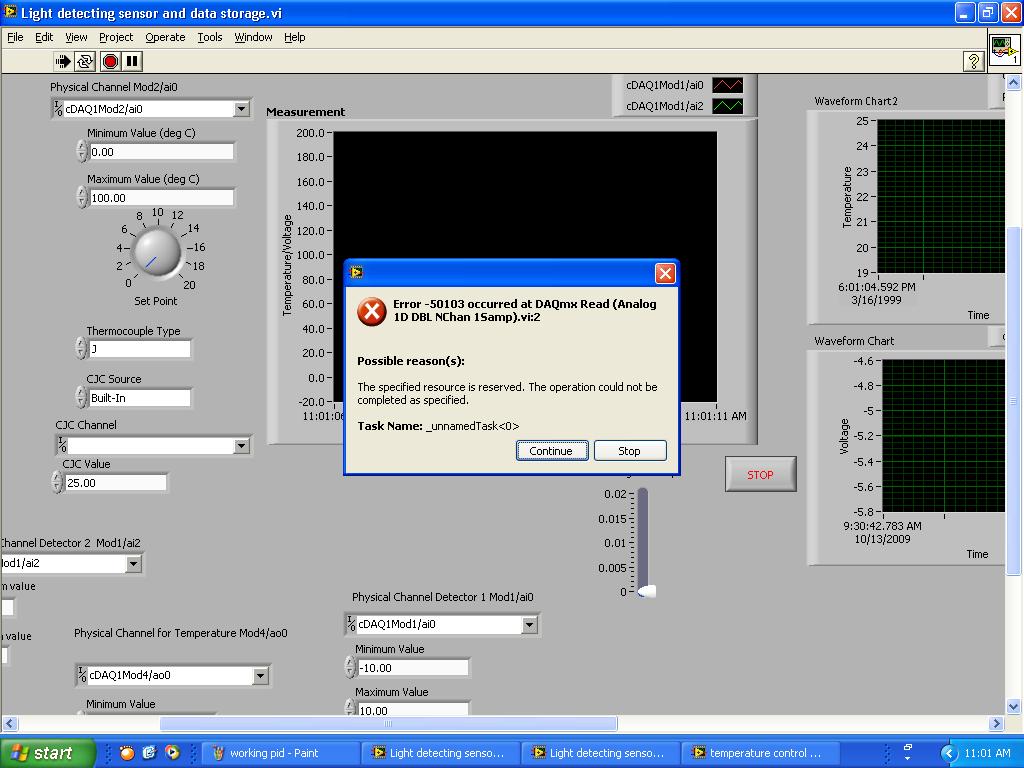

and when I try to run both the VIs at same time, the following error appears,
and I think, it is because that both the VIs has the settings for same thermocouple and can not acquire the data (teperature) at the same time.

Did you try doing a search for that error code? You've made a very common mistake and the answer is to simply have both channels in the same task. In your first VI, you would add another DAQmx Create Channel to the task.

Why not? You created the original VIs didn't you? As I said, you just have to add another DAQmx Create channel to your first VI, this will define the termperature channels(s) that you have in the express VI. These new channels are new elements in the waveform array that you get back with the DAQmx Read. Index these out the same way you indexed out the other channels.

You will not be able to aquire the data at the same time from two VIs. You should collect it in one place and apss it on.
