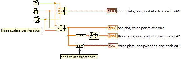

Not sure why you have "stacked plots" enabled, because that's not the default, so undo that (right-click...stack plots). And yes, just show the digital display of the charts.
How much history do you want to keep? Default is 1024 points per plot, but you can change that at edit time. Don't make it gigantic, though. Keep it reasonable.
I imagine you don't have problems with the scaling, but of course scaling a temperature between 0 and 100% seems questionable.
Let's assume you have three values per iteration. Here are some possibilities and the best depends on the situation. Some are better if the number of plots is not known at edit time.

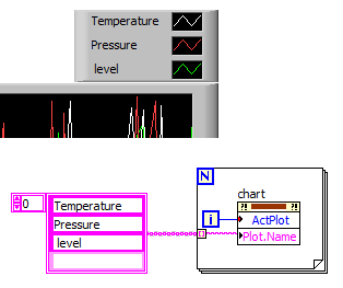

Just one more question, (I will try to sort it out myself, but in case if not), is there possibility to define names for charts as e.g. in MSExcel? As I spot the Y axis name has disappeared, what is logical.
Not sure what you mean by "names".
All are just strings and if you can read them from a file, you can write them to their respective property (plot name (make sure to define the active plot first), axis names, legend, etc.) You cannot change the label, so show the caption instead)
Here's how to set the plot name, for example.
