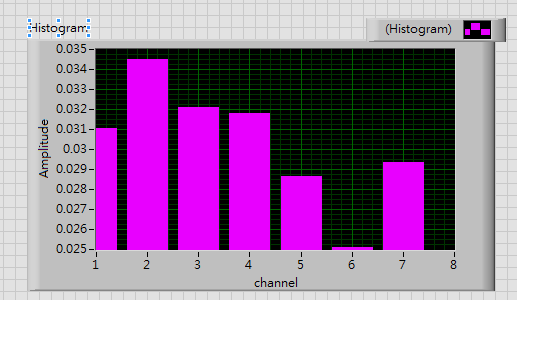

Q1 : x-axis the number 0 and the number 7 width is the half of others , how to change same width?

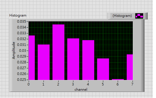

Q2 : x-axis from 0 to 7 , I want to change the 1 to 8, but I direct change in the pattern , it will become following picture
The entire graphics will shift , How can I solve?

A1: You cannot currently change the width of the bar at the edges of a chart to be the same as the ones inside of it.

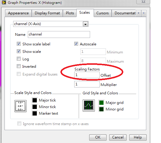

and I have been solve my second problem , choose properties->scales->Offesets

Yes, I'm sorry - we currently have this in our CAR(Corrective Action Request) database but it has not yet been actioned.
