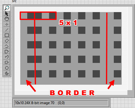

Anyway, for this test, I will fill the image 10x10 with 160 and put a grid of dots with I = 70:
When you perform IMAQ Convolution, NI will grab internally the pixels outside of the image (called border). For a kernel 3x1, you will need one pixel left and one right. They will have the same intensities as neighboring pixels:
Now for the first pixel, we will take one from the border (I=70), another one from the image (also I=70), and next one, which is 160. As a result, (70+70+160)/3 = 300/3 = 100. This is what you have. The next pixel (moving to the right) will be computed from (70+160+70)/3 and again 100. But the next one is (160+70+160)/3 = 390/3 = 130. And on the right side, the border is 160, therefore you have two same pixels in dst with I = 130. So, your image after convolution is:
It's a little bit more complicated with a kernel 5x1. Here you will need two pixels outside of the image and they will be "mirrored".
(I do not set Border, because by default every IMAQ image created with border of 3 pixels, which is sufficient for convolution up to 7x7. From 9x9 you will get an error, and the border needs to be increased)
There is an IMAQ Border function, but this has no effect on convolution.
The IMAQ convolution will always fill the border with mirrored pixels and in our case:
Now if you will compute accurately moving convolution window, you will understand how this dst image was obtained:
because for first pixel (160+70 - these two from border +70+160+70)/5 = 106. And so on. The results are not strange; it is pure math. However, if you still have questions, don't hesitate to share your code snippet and the result, along with an explanation of what you expected to get and what you saw instead.
