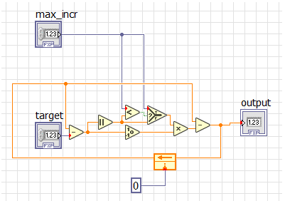

I need to run the following code in LabView FPGA, hence I need to use FXP.
Everything works fine and stays at FXP until I insert the feedback node. Then the data type flips to double and it can not run on the FPGA any more:feedback node and types.PNG
How can I force all the internal wires to be FXP?

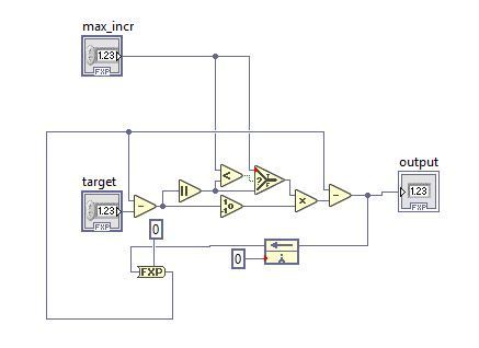

I was able to get it to play nice by adding a to fixed point after the feedback node ¯\_(ツ)_/¯
Can you do that in FPGA land?
Message 6 of 10
(5,211 Views)
No it is still not working, because the wire section between the Feedback node and the "to fixed-Point" is displayed as double, which is not allowed in FPGA land...

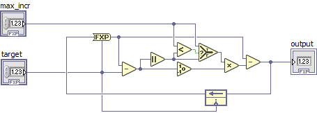

Did you wire the fixed point type?

Awesome, I think I tried every Permutation, but failed to add the constant to the fxp converter.

Especially with FXP, it is not advisable to have all these diagram constant floating around, it makes things much harder to maintain, e.g. if you would change FXP type. (Herding cats comes to mind :D)
I would just source all the types from the same place instead. (... And if the FN should be initialized with zero, just change accordingly).
(And yes, type propagation sometimes fails, so there is probably a small bug somewhere)
