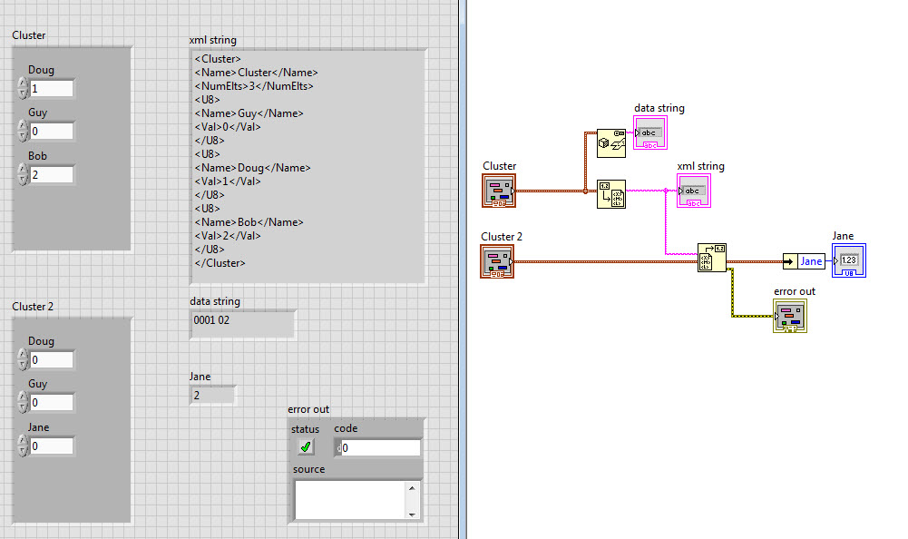

Here's the basic opperation, using 2 clusters of the same makeup but have different names for one of the elements. The last element is "Bob" when the XML string is created. It's unflatted as "Jane" and works just fine. The data string also confirms that the makeup of the transmitted data is just the 3 bytes. There is no information that describes what it is. So, changing the name has no effect...so long as there is a consistent structure on both sides. Not recommended...but in some cases it's easier to do this and fix the typedef later when there is ongoing testing.

Words to the Wise -- while I can "believe" that opening a TypeDef and changing only the name of an element would not make much difference, be very careful if you do a "delete/recreate" cycle, where you delete the element "Bob" and add back the element "Jane".  Not only do you need to worry about getting the "types" right, but you also need to ensure that you don't disturb the "cluster order".  In particular, if you delete any but the end element and replace it, your new element will become the end element, and unless you reorder the elements in the Cluster, they won't "line up" properly.

That's rather a weakness of the LabVIEW XML format.  Including names, but then ignoring them and only going by order, is confusing at best.
