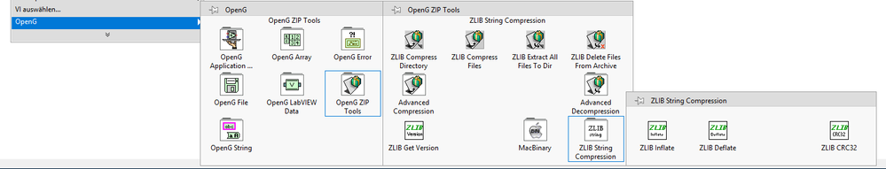

The OpenG ZIP tools do not only work for files. They also expose the compress and inflate routine from the ZLIB library that is used internally in the ZIP algorithmes. So it may still be a solution depending on how "sadistic" that programmer was?
That said, it sounds a lot like LabVIEW files. They compress most parts inside the LabVIEW files with the ZLIB compression algorithme too.

@D-Kid wrote:
at first, thank you very much for your message, mcduff.
However, I am afraid that I cannot use these suggested VIs due to the fact that these VIs dealing with ZIP files only.
I do not want to generate or handle with ZIP files at all.
Regards
DKid
yes, you can:
Message 9 of 11
(7,506 Views)

@alexderjuengere
Thank you for the showing 🙂
You are absolutly right. I could use it, but...
Regretly, this function gives me always an error 42. Which means that something went wrong during the unzip step. Further, it is also just available in a 32bit environment but I am going to use a 64bit environemnt due to the huge amount of data which can occur. Therefor I can"t use these functions for my purpose.
I also talked with my colleague again and he mentioned, that he had used the unzip/zip functions from a LiteZip.dll, a free source compressen/decompression library.
In my point of view, the functions contained in the LiteZip.dll are the quite same which are used in the ZLIB VIs.
In your point of view: is this right?
If so, any ideas except to create some VIs from the LiteZip.dll?
