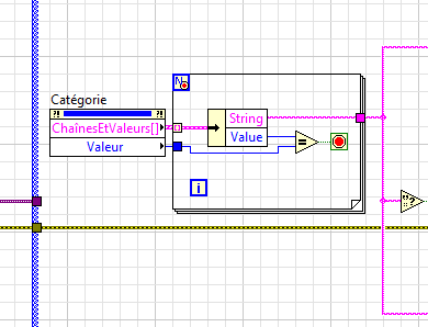

Property node : look why this is so practical :
Compiler : I'm not responsible about how things works inside the compiler.
Where is the info about the difference between 'local variable' and 'property node' ?

Hi David,
That's what I wrote: you can chain several properties in one property node.
And I also mentioned: you are responsible for efficient algorithms. Fetching strings/values by switching threads isn't considered "efficient"…
You could replace this whole snippet by a FGV holding the strings/values in a shift register and looking things up using Search1DArray (or Variant attributes). No need to constantly force UI thread calls…

Hi David,
I'm not supposed to know what going on under the hood, the whole "you should optimize your code" stuff shouldn't even exist in the first place.
You can create code in each programming language. You can create bad code, you can create better code - in each language.
Once you want to create "efficient" code you need to know the internals of the compiler (or atleast the most important ones) - in each programming language…
Even when coding in pure Assembler you need to know how to optimize your code!
Is there a profiler I should waste my time on just to tweak things ?
Yes, there is a profiler. You can find it in the tools menu.
The shift register wouldn't do it.
Why not? I use that approach very often…
To answer your thread title:
Write a small VI using LabVIEW scripting to color your case structures as you like to. Maybe you can also use that VI as plugin in QuickDrop!
