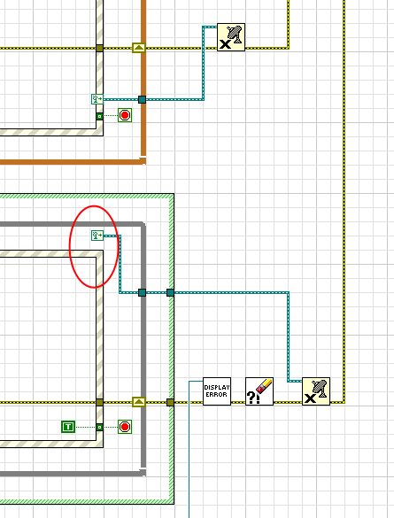

Kochise wrote:
I'd like to know if there is an automated way to change
conditions' color following the linked data type on the
diagram, so that it's a little bit easier to know what kind
to processing is done when you don't have the whole
thing on screen. Currently I'm doing it manually :
David Koch
Everything else in the thread notwithstanding, you should be able to do this with VI scripting if you really wanted to. I can't find the property for a CaseSel's border colour, but you can most definitely get the selector outer terminal data type. I've used it for colouring each frame colour differently before. It'd work well as a QuickDrop plugin.
For easily maintainable code, however, there are far better alternatives - even if they're harder to fit into your inherited code.
Good luck.

Accepted by Kochise
Although it is possible to programatically access the data type and color of the wires, there is no way to programatically set the color of the frame of a case structure.  However it is possible to set the background color.
See attached code..
Message 18 of 22
(2,197 Views)

This is a little better.  It sets the BG color of the subdiagram label instead of the diagram.  (Still needs sub-vi "Flatten Diagrams.vi" in my previous post.
Message 20 of 22
