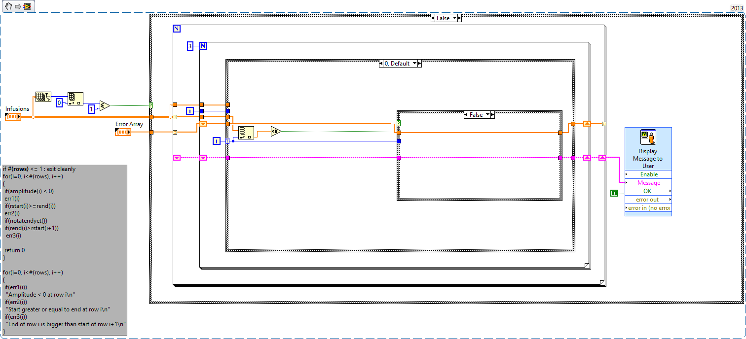

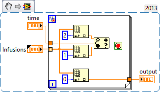

My design looks something like this:
With error checking that looks like this: snippet4.png
My question is, is the array based approach optimal? How else could I tackle this?

I fixed some faulty logic and got rid of that concatenating string thingy. This should be much better at error checking, even though it spawns a windows for each individual error.

Okay, sorry for the diagram confusion. I made the labels before thinking about associations. T starts at 0, and the infusion is 0 for some amount of time (or no time at all, the user decides this). Then, at a user specified time, an infusion of some amplitude starts, and stops at another user-specified time. The user can repeat this as many times as they want. Two infusions can't run at the same time (even for just a small amount of time, hence the error checking), can't be less than 0, and the start time must be less than the end time.
Now, I'm implementing this by allowing the user to fill in values into an array, which are then checked. There may be a better way to do this, though. The pics are snippets so you should be able to download the VI directly.

Sorry for the poor explanations. The array will be user-editable, so they can enter whatever they want. That's why it needs to be checked for validity. Column 1 is amplitude, column 2 is start time of infusion, column 3 is end time. They could enter (-5,4,2), which is invalid, but I have to check for that. That is, unless there's some other way to do this that I'm missing.

I haven't looked at the code, but there are a couple of things you can change:
  1. You can right click the control in the array and set its properties so that the user can't enter negative numbers (and then you don't need any error checking).
  2. You can change the logic such that instead of a time index, the user inputs a duration. So your array might have a ring (to set the type none, R1, R2, etc.) and a duration. Add up the durations and you know the relevant time index. If you want to be more fancy, you can do something like this:
