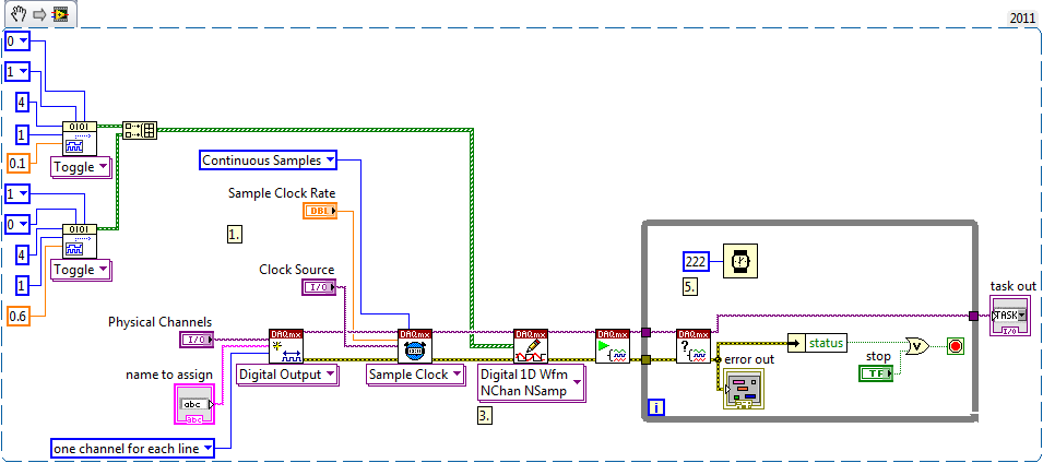

Thanks for your posting in this forum. For your first question I attached some example which is maybe useful for you.
