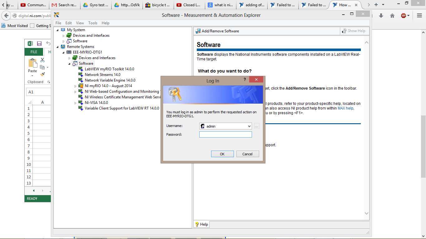

I am trying to install a software into RT Target(myRIO) through MAX. By right clicking on the "software" icon and selecting "Add/Remove Software", it appears to be asking for password. I tried to used my NI username, but it only accepted the "admin" as the username and the password for it. What is this "admin" username is referred to?
(4,501 Views)
Hi hafiz,
you can set admin password on a my/cRIO RT hardware. To change important settings you need to login using that admin password.
So you need to ask whoever gave you that myRIO…
(4,497 Views)
Hi gerdW,
Thank you very much for the reply. Indeed, it is the username and password of the board's owner. Smiley Wink
