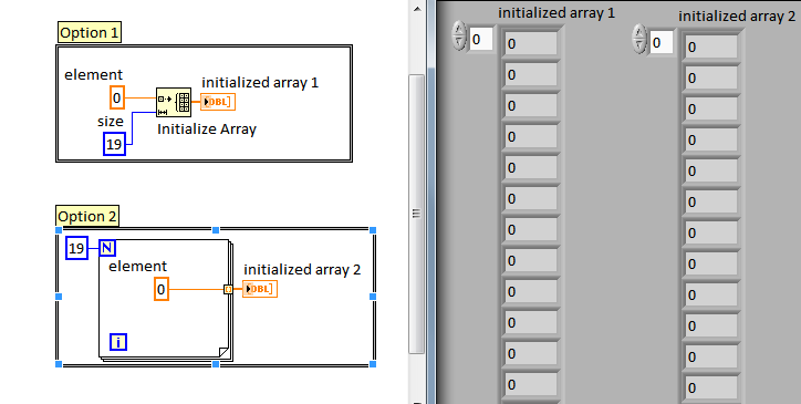

Hello LV_Enthu,
As Bob said, there is the two way of initialize array, you can follow any of the method which are displayed in image.
Vinal Gandhi, CLA

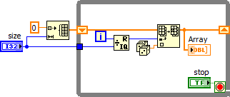

Hi PBP,
the OP said to use LV8.0, so your LV2012 VIs aren't accessible…
It's like in C language, where-in you define array_size in init, and once the array is full, you overwrite the 1st element and so on.
Try this:
It defines an array with a certain size and fills it by overwriting the elements. Thanks to QR operation it starts over with 1st element once the array "is full"…
