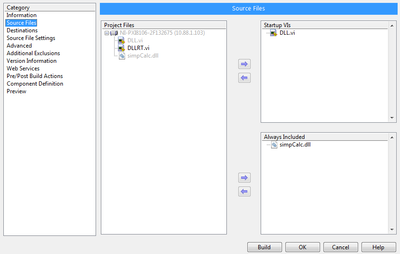

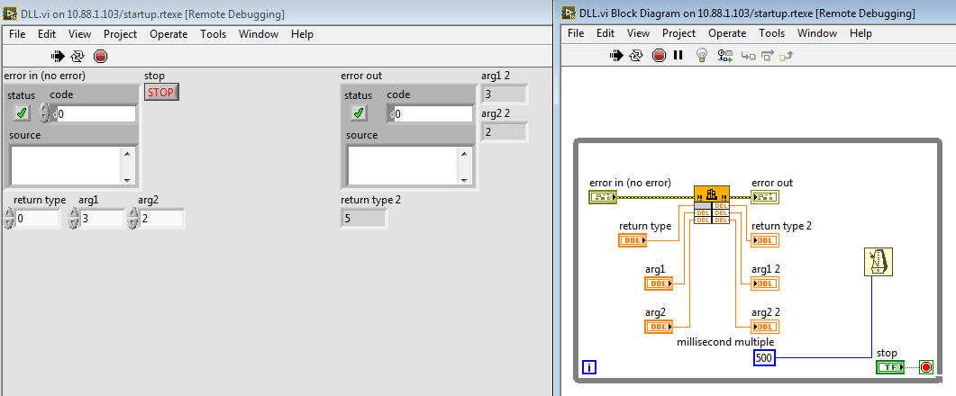

(5,716 Views)
Hello Guillaume.Cl,
i tried it on an 8106 RT system with LV 2016 and it worked. I build the RT application with setting the dll as always included and enabled debugging under the advanced settings. The dll was copied on the RT target automatically into the data folder.
best regards
Alexander

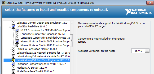

Hello Guillaume.Cl,
have you installed the CVI runtime engine on the system?
best regards
Alexander
Message 9 of 14
(5,704 Views)
Thanks for replying.
I checked for Labwindows 2015 run time engine but I don't have it and I can't install it on my cRIO 9081.
Maybe it worked for you because your target is a pxi?
Thank you
Message 10 of 14
