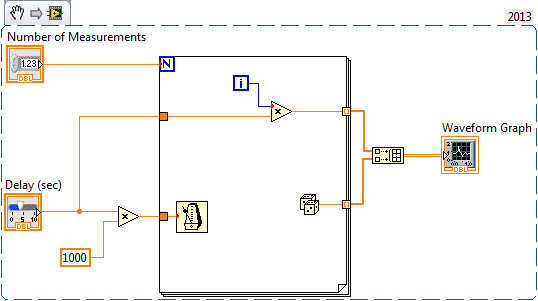

Hi! There is the problem that I am facing now, is the connection that says,
You have connected two terminals of different types.
The type of the source is cluster of 2 elements.
The type of the sink is 1D array of
    double [64-bit real (~15 digit precision)]
how to figure this out and may I have the solution, please?

If you look at the context or detailed help for the graph, it explains the data types that it accepts. The waveform graph is used for displaying a complete set of time-series data with a uniform time between points. (with a t0, dT and Y values). It accepts either a 1D or 2D array of points (where t0 = 0 and dT = 1) or a waveform.
You are probably looking for an XY graph instead of a waveform graph - that is used to display an arbitrary plot of X & Y values and accepts a cluster containing an array of X and Y values.

Looks like you are trying to feed a cluster of two elements into a graph that is expecting a 1D array of numbers. Where do you get your cluster from, and what are the two elements in it? Normally you would have an array of data to feed into a graph (feeding in just one point kind of defeats the object of having a graph) so why do you have a cluster rather than an array?

You need to wire it to a XY graph the way it is programmed in your VI.  The first array contains the X values and the second array contains the Y values.
Now, if it's not what you want, you can still use a waveform graph but instead of using the bundle cluster use the build array, but this will create two waveforms.  See examples below:
