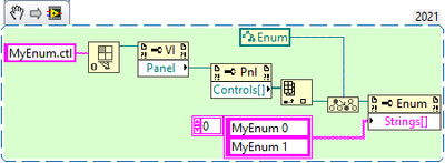

You can, but the Enum must not be reserved for execution.
This example works as long as no running vi uses the ctl:
Of course, the file MyEnum.ctl must exist already.

Great! Can you provide the vi for references? Thanks.
It's a snippet. Save it as a picture (.png) and then drag it into a Block Diagram.
Of course, you need LV>=2021
