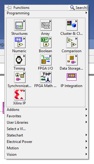

I have MyRio and LabView 2014 with all the modules installed and updated.
Xilinx 2014 is also installed and I can compile for FPGA.
However in block diagram I can't find HDL interface Node for importing VHDL code. As you see in the second screenshot.
How may I solve this issue?

Try searching for it by clicking on the search button on the functions pallete or by pressing control+spacebar.  You can also change your visible palletes to all and browse that way.  Good luck.

You mean that IP Integration node?
Message 3 of 8
(6,838 Views)
I can find IP integration node. However I'm looking for HDL Interface Node as it is mentioned in the following whitepaper:
https://www.ni.com/en/support/documentation/supplemental/06/importing-hdl-code-into-fpga-vis-using-t...
I think the functionalities are the same. Maybe NI has replaced the HDL interface Node with IP Integration Node?

I know this thread is really old but just to help clear things up from aan928's confusing solution for anyone else who comes across this forum post:
The HDL Interface Node was replaced with the IP Integration Node beginning with the LabVIEW 2010 FPGA Module.
