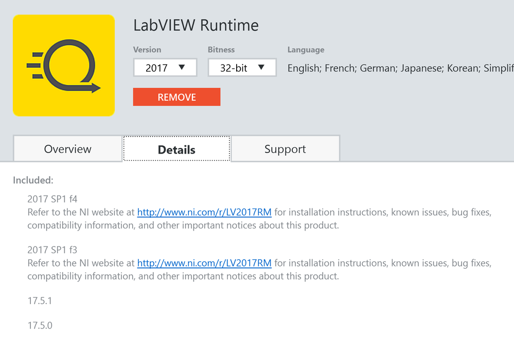

Thanks, I thought about doing this, creating a "dummy" installer that installs the patch, but instead I found the "installer" in the NIPM cache ("NI LabVIEW Runtime 2017 SP1 f4 (64-bit) [17.64.49153]") and requested approval to install it using the .msi file since there isn't a typical installer program (setup.exe).
I checked MAX and it now has the correct RTE patch.
Doing all of this seems a bit hokey, so I'm hoping this isn't the new norm.

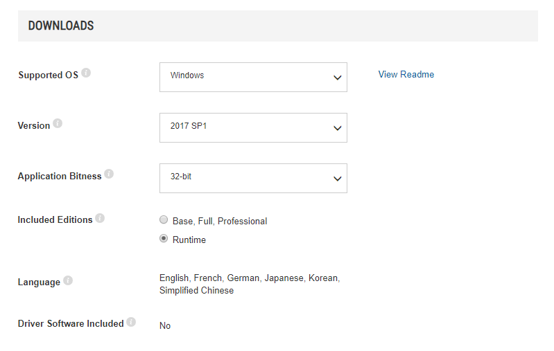

@BruceMoyer wrote:
The link to download LabVIEW installers doesn't even let you download RTE installers.
Yes it does. And it looks like it downloaded the latest patched version for me because the file is called "LVRTE2017SP1_f4Patchstd.zip"
Message 9 of 12
(3,567 Views)
Ah, instead of looking at the patch we should be looking at the actual version.  Not sure how I feel about that.  Seems confusing.
