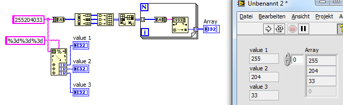

Hi pdpanchal,
you REALLY should put a delimiter between those values from your "proteus"!
See this:
Two ways to convert your string into numeric values.
One of them is just for fun, the other is recommended…

Your incoming data string has spaces.  But your format string does not account for that.  Add spaces to your format string.
Message 8 of 19
(5,360 Views)
For simplicity, you could even use "spreadsheet string to array" with a 1D I32 array as type, %d as format, and "space" as delimiter. Now you would get an array of three elements and 3x fewer terminals and clutter.

Hi pd,
it's nice to see you took the suggestion to put some delimiters between your values!
But you need to adapt your format string to those delimiters…
Or use (as suggested before) SpreadsheetStringToArray instead!
