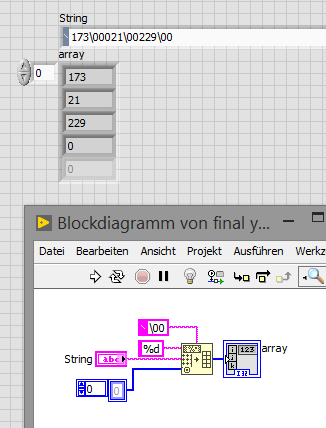

Hi pd,
every single item in the image is important:
Using a NULL byte as delimiter was a bad decision. It will give you headache when trying the same with other programming languages! Better use a comma, semicolon, or even a real SPACE…
Why did you try a delimiter of ' ' (including quotation marks) in your VI???
Is this really your "final year" homework?
