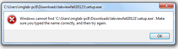

I  am trying to install labview 2012 on my Windows 7 64 bit system,but it fails;
Here is symptom:
1) I click the setup.exe directly and it shows that:

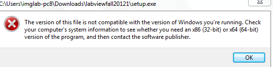

2) if I run it with administrator, it shows that:

Hi Bestchun,
It could be a corrupted installer file. Please try re-downloading the installer from ni.com/downloads.
I'll monitor this post, so reply if this doesn't work for you.
-N
Staff Certification Engineer
(2,813 Views)
Hi, Thanks. It was caused by the windows 7 extracting tool. When I use WinRAR, it works.
