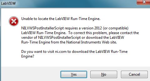

I’m having an issue with Labview runtime.
On my development PC I have: W7 Pro 64 bit + Labview 12.0f3 32 bit
On my Target PC I have: W7 Pro 64 bit + Labview runtime engine 32 bit (lVRTE2012f3std.exe)
When I copy a .VI to my target PC I can’t open it. I got the attached message.
Any suggestions?

Copying a VI does not allow you to run the program in System where LabVIEW runtime engine is installed.
You will need to build an Executable and put that executable on system where Run-Time engine is installed.
Search for the "How to build executable in LabVIEW " for learning.

Better believe it!
In order to run a vi you must have the development system on the machine. And only the Professional Development System allows you to make an exe-file that runs with the run-time engine only.

I don't know if older runtimes were capable of independently loading and running VIs (although, unlike the others, I do have a vague recollection of hearing or seeing something like that), but just to clarify Dennis' reply, here's what you need to do:
Write a very small program. All it needs to do is use the Application class property Command Line Arguments to get the path of the VI and then open a reference to that VI and use the CBR node or the Run VI method to run the VI.
Build that application into an EXE (I think you need to explicitly enable command line arguments in the build spec) and then register the VI extension to activate your EXE (manually or through the Windows registry). I never did this, but you might need to set the Open verb to pass the path of the file to your application.
___________________
Try to take over the world!
Message 9 of 10
(7,863 Views)
It seems that now (LV2012) executables are still packed libraries of VIs (they are compiled files, you know): you can access test.vi, included into executable by writing aaa.exe/subVIs/test.vi. Here subVIs folder is the path to the test.vi relative to the main VI of the executable.
To run a vi file you should somehow tell the system to run it: when you double click the vi, Windows does not know that it should start it, but not call an associated program. I think that exe contains the mentioned code that uses runVI method for the VI, marked as startup. Or the instruction for the system to run this VI, that is the same.
To run another VI, you need to use run VI method manually on it (as tst has offered). This VI can be located anywhere - in packed LabVIEW built exe, folder, network.
