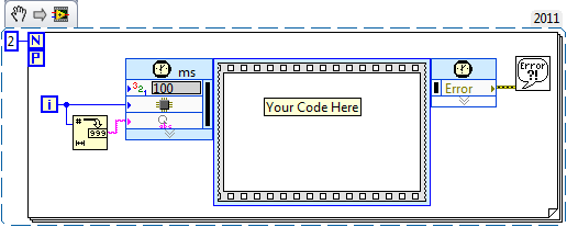

If I try to place a Timed Structure in a Parallel For Loop, the TS needs a different structure name per instance to prevent collisions. However, setting the Structure Name node  to something unique per instance doesn't work, I get error -808. Have I missed something?

I get the same error even with N=1.

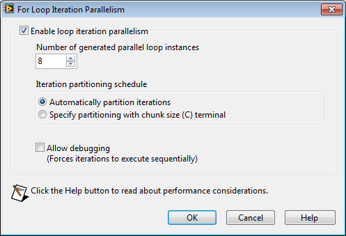

That got me thinking - something to do with the number of compiled parallel instances.
Indeed, the compiler creates a number of parallel instances of the for loop in the compiled code (in my case 8), and uses the number requested at the Parallel Instances terminal (just under the Iterations terminal), which is set to 2. Therefore the compiler has created 8 instances of the Timed Structure, each in its own for loop instance, but they all have the same defined Structure Name. When launched, there is an immediate conflict because they can't share the same name, and error -808 is launched before the set Structure Name function can change it. Hence the error still shows when requesting only one instance, because the other seven still exist.
I guess this means you can't have Timed Structures (or Timed Loops for that matter too) in a Parallelised For Loop?
I'm afraid you are right,
but then why the "find parallelizable loops" tool doesn't warn us of the issue?
