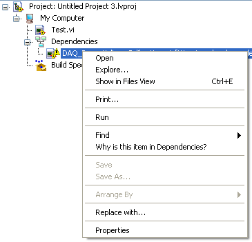

This is what I see:
When I select Find | Callers it refers to Test.vi but there is no code in this vi.
I addressed it as a conflict but I now realize that is a maybe confusing. It is not a conflict but a missing vi.

Hi Steffan,
a conflict usually occurs when a VI is referenced in two different places (as file on your harddrive).
A conflict in the dependencies usually doesn't harm…
Edit:
When I put your VI in a fresh project (LV2014) I also see this depency in the project. It seems your VI is "kind of broken" as it seems to reference a missing "DAQ_..." VI which doesn't exist on my harddrive apparently.
Solution: Delete this "Test.VI" and create a new clean VI!

Hi Steffan,
recreate that "kind of broken" aka "insane" VI from scratch…
(5,658 Views)
Yes, it looks like this vi is kinda corrupt. It consists of a sub vi that is not visible on the diagram or something like that.
Creating it from scratch will solve this issue I guess. Thanks!
