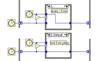

There's quite a few things wrong with your code, mostly style issues. Wire bends, right to left wiring, etc.
But the simples part might be what's causing you trouble:
Are you sure that times is called every ms? If it returns 6, 11, 14, 18, etc, the output might never become 0. You need to keep the previous save time, and compare the current time with the last time + interval time.
Are you sure that output ever gets 0? The integer is converted to a double, and that causes rounding. The output might be 0.00000000001. That 5 needs to be an integer. You probably be OK in this case, but you're walking on thin ice. And without good reason.

Thank you for your reply. I see your point, it could be, i thought that tick counter returned the ms value of the timer. How can I store the old value of my timer until the new value is 5 ms higher than the old value? I can't figure out a method.

Hi Dave,
You should carefully read message#2 again and look at the images in that message!
Ever heard of shift registers?

In retrospect, that code wouldn't work.
The ms count is a U32 so 0 + 5 could take a long time to get the first trigger. The compare won't work well... Once the count wraps to 0, it will again take a long time before prev + 5 > current...
But the shift register is the key.
Something like this:
The subtract results in a valid dT, despite (or because) both values are unsigned.
If the U32 wrapped, you'd get e.g. 5 - (max U32-5) = 10
Of course you can save the U32 drama and use Get Data/Time In Seconds or High Resolution Relative Seconds.vi

I tried the same configuration, but I think it is possible that the difference never get exactly equal to 5 as you said in your first answer. When i tried what you showed me my file ends up to be empty. So after the difference I had to put a greater compared with 5. Now the file doesn't end up empty, but the frequency is not 200 Hz, it is like 10 Hz. In 10 seconds i get 100 samples. I don't get what is wrong..
