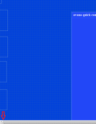

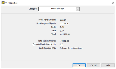

The block diagram alone is 22+MB! Also, the origin is reported near to start near coordinate -25700.
The front panel also seems way off-center, with toptleft at ~=15k,-15k. For example if you do a "select all", there are cutoff outlines outside the scrollable area.
If you do a "select all" on the front panel and paste it into a new VI, you get tons of terminals in one big pile.
If you do the same on the diagram, LabVIEW stops responding and the front panel gets many, many screens big ( ~10x is width and height, judging from the scrollbars). I let it at "not responding" for a while and finally LabVIEW 2019 crashed. I won't try to re-open this VI.

The while loop on your VI hit the size limit which causes all sorts of trouble.  Easy enough to fix.
You are playing with fire with this huge BD (and the locals, and the sequences).  I'd suggest you take a deep breath, study a few LV tutorials, and then start working to shrink the code.

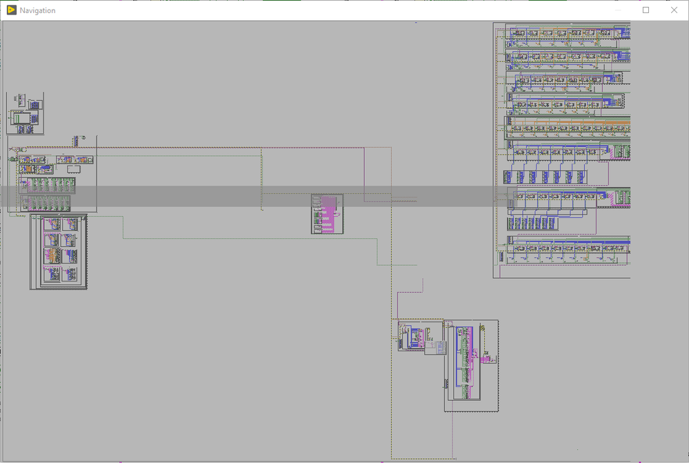

Oh, what a mess! It might be easier to start from scratch. Even bringing up the navigation windows takes 30 seconds and then the navigation image is corrupted. Diagram is sitll ~40k x 30k 😞
So. Much. Duplicate Code.
Notice that the grey area does NOT resemble the window aspect ratio at all. Even on the diagram, the top while loop does not draw correctly, here's the upper right corner for example:
