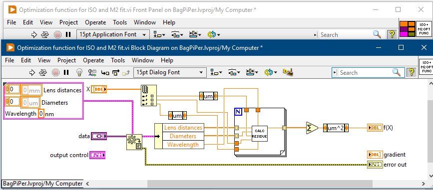

This is that VI:
Most details are unimportant.  It's an optical calculation designed to minimize area.  But you can see the function has an output directed at the f(x) indicator, and that's what the "Unconstrained Optimization VI" tries to make as small as possible.
If I had wanted to make it as large as possible instead, I could have just inserted a reciprocal function right at the very end:
A "Negate" node to make it negative would likely work too.
