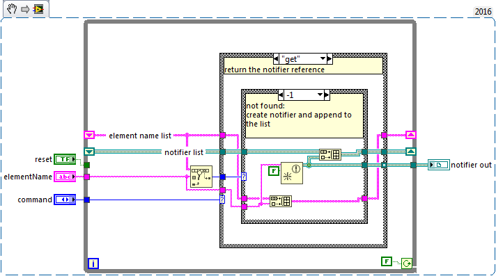

I created a functional global to manage a list of notifiers (see attachment). It returns a notifier reference according to the element name specified as input.
If a new element name is specified, a new unnamed notifer is created (Obtain notifer). If an existing element name is specified, the notifier reference (previouslty initialized) is returned.
This structure is used to manage notifier for classes. Different classes use different notifiers.
The first time I call the FG, the notifier is initalized and a valid refnum is returned. The second time I call it, Invalid Refnum is returned.
Why this?

It may be because you have no Initialise case.  The arrays may not be empty when you start, and so the names and values may not match, or the references may be invalid. IN your initialise case, empty the arrays.  It is also worth mentioning that this is a prefect use case of a Variant Lookup Table, which will perform faster and with less coding than the search 1d array method you are using.  There are many examples of variant lookup tables on these forums.

I've added the initalization case that empty arrays but this strange behaviour remains,
I'm looking at Variant Lookup Table now. I didn't know it. Thanks for your suggestion.

Between the first and second call, does your VI go idle?
If so, the notifiers are being destroyed when LV clean runs.

please make a simple test VI which gives you the strange behaviour.  I tried your VI and it works as far as i can see

You should wire the new element name to the Obtain Notifier name input in the not found case.

Exactly! Name them notifiers.
Of course, then you can really go back and DELETE the element name list Smiley Surprised and throw the whole vi out the window as well
Spoiler
Just use obtain notifier-  All the FGV functions, including the variant lookup method suggested, are done under the hood-  LabVIEW is just like that sometimes, Smarter than we are

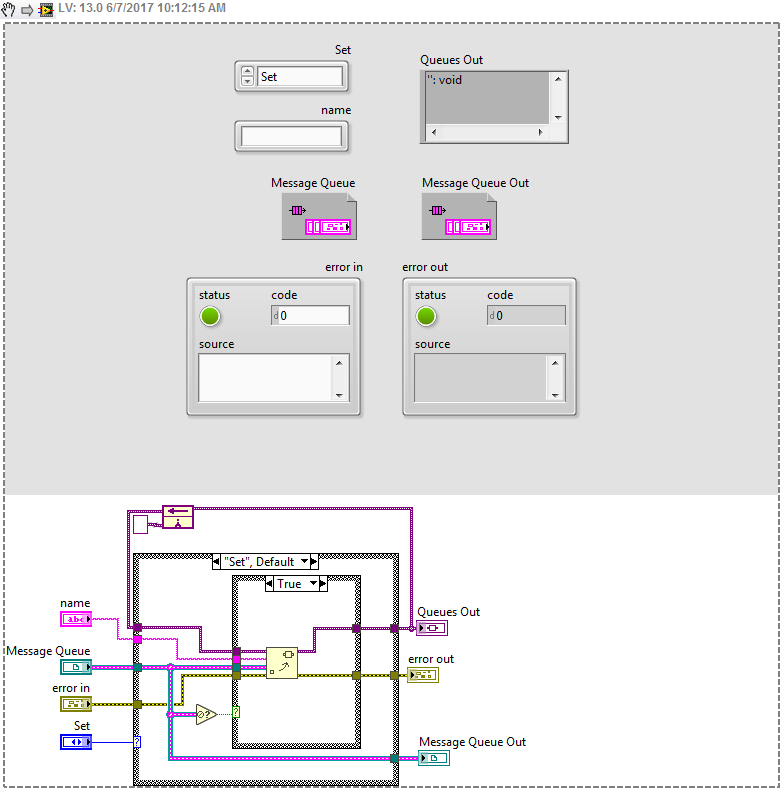

In all fairness, There are reasons to do exactly what was suggested.  To Wit: there is no method to return the names of all notifiers in this application instance.  This could aid a developer trying to figure out just where they typoed a name and got a new notifier rather than a reference to the notifier they wanted.
Attached in 2017
I just recently modified an lvlib that can be found in some shipping template projects to add a feature like this for Queues. (And disconnect a cluster typedef that I didn't like)
The example is missing dependencies.  (I have to hold something back in my pocket)
