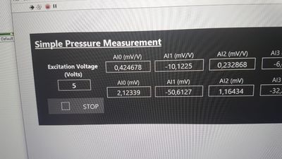

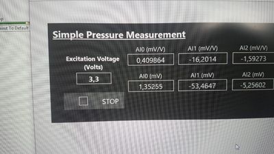

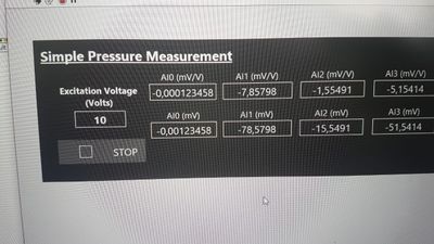

I'm using a NI-9237 with a RJ-50 connector model and double-checked my connections, which are correct. The cables came with my entire order (composed by cRIOs, modules, transducers and cables) and these cables are from Honeywell, just like the transducers. I made some more tests that may help to troubleshoot. It looks like that when the excitation voltage is 3.3V and 5V, output values are coherent, but when raised to 10V, this tension drops abnormally. Down below you can see the pressure measurement VI I built. There was a transducer connected only to AI0 (other signals were noise), the upper field shows mV/V voltage and the lower one represents the final output based on excitation. The only changes I made between images are related to the excitation both on the VI control called Excitation Voltage (Volts) and module's configuration in project manager. Also, I tried different cables and transducers, but found the same behavior of the following results:
Excitation of 3.3VExcitation of 3.3V
Excitation of 5.0VExcitation of 5.0V
Excitation of 10.0V - Abnormal valuesExcitation of 10.0V - Abnormal values

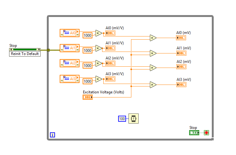

I am also attaching a VI to show the block diagram of this code in case my description was confusing. I'm multiplying the Inputs to represent V/V in mV/V then considerating excitation voltage:
