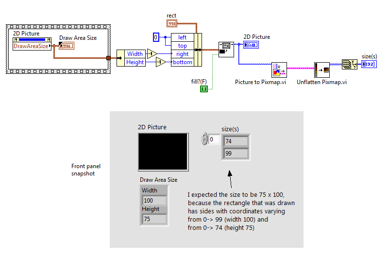

Unflatten Pixmap unexpected behavior
This is not actually a bug in the function Unflatten Pixmap but I see a fail in the function implementation.
It seems that the output is missing the an entire line and collumn of the array corresponding to the input picture.
What is your oppinion ?

What version of labview are you using?
Message 2 of 8
(5,728 Views)
I am using 2010 and get the same results when programed like your example. It appears you have found a bug. A work around would be to just remove the decroment from the width and height,  The image data is missing a row and column worth of data so the array size is correct at 99,74.

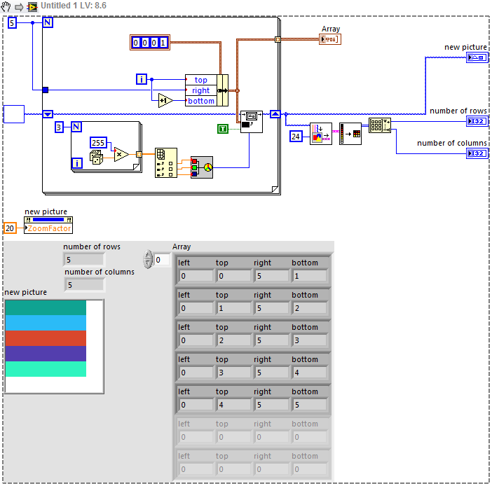

I think your problem is actually with the draw rect VI - it looks like you shouldn't substract the one.
You can see that you actually need to have a rect where the top and bottom row are different to draw a rect with one row. I have no idea if this is correct or not (at face value I would say no), but that seems to be the source:

It's correct if you consider the origin of LabVIEW. The LabVIEW pixmap is modelled after the Macintosh PICC format. On the Macintosh the pixels were not located on the screen coordinates but in between. A small but pretty important difference. So a PICC starting at 0 and ending at 10 had 10 pixels across, not 11 like it would have for a Windows bitmap.

Yes tst, you're right. I've actually found it a few moments after I'd post the problem, however I forgot to put across.
I'd read in another comment to this subject that this is because of the Mac origin of LabVIEW. How about to fix it now ? 😉
