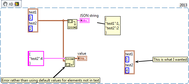

Unflatten from Partial/incomplete JSON File
I've been using INI files to store configuration data, but I'd like to move to JSON.
When doing a "Read Key" from an ini file, is the key doesn't exist I can specify a default value.
This doesn't seem to be the case for JSON, is there a way around it if I only want to store some elements of the cluster and any that aren't explicity declared use the default value? It looks as though I'd have to explicity declare null for any elements that I don't want to save.

The problem is that although we are using these strings to pass data, at its essence a JSON string is defining a data structure. Consequently, while the two strings might appear very similar to us, they are describing two different data structures so simply unflattening won't work. You can however parse the string yourself and by knowing the labels of the elements in the structure parse out just the values that are present.

Try an alternate JSON implimentation, such as the one on LAVA.

The OP wants to use JSON to store configuration clusters, presumably without writting a lot of custom parsing code.  Simple parsing will also be unable to handle duplicated names, such as the JSON text:
{ "Operator": { "Test 1": "Joe", "Test 2": "Mary" }, "Test 1": 1, "Test 2": 2 }

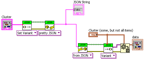

Is there a reason you aren't using the JSON implimentation on LAVA?  It does basically the same thing, only it's complete, and handles arrays, subclusters, and a large number of LabVIEW datatypes.
