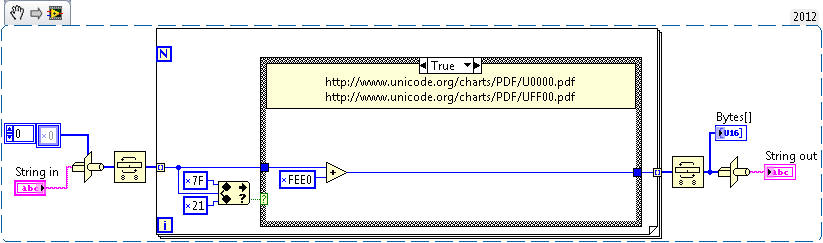

The ring text is shown until the first unicode character appears that contains a /00 this do all ansi-characters.
This is true for all U+nn00 characters too.
A workaround may be to use "Halfwidth and Fullwidth Forms" you find them in the range U+FF10 onwards.
In other words: replace all U+0021 ... U+006F characters by the characters where you have 0xFEE0 added to the values.
A replacement for the space-character may be U+202F (NARROW NO-BREAK SPACE) or U+F2001 (EM QUAD)
(Perform the replacements before you use "Tool_Unicode Update Ring Control.vi" which you find on Community: A List of Tips and Tools for using Unicode in LabVIEW)

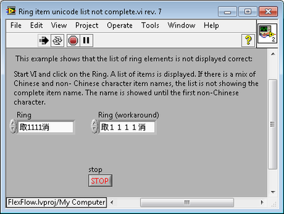

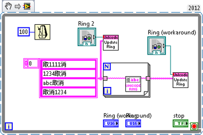

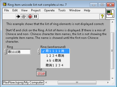

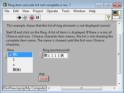

Finally, i managed to work around, even if the result is not perfect. A space between every char is shown in the text ring. Does anyone know how to solve this last question?
ring_unicode_bug_1.pngring_unicode_bug_2.pngring_unicode_bug_3.pngRing_unicode_bug_example.pngRing_unicode_bug_workaround.png

Hi OriginalP,
I absolutley want to help you solve this problem you are encountering, but I'm having a bit of trouble understanding what the "last question" is. Since this thread is very old I would highly reccommend starting a new post with the last question you are looking to solve and allow the community to take a look at it with a fresh set of eyes.
