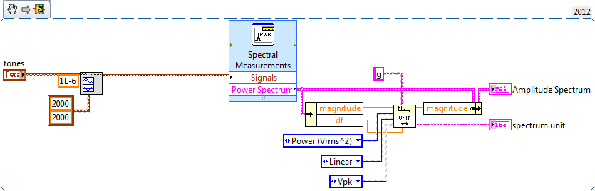

I suspect you had rms instead of peak units, and that is why you didn't see the amplitude (implies peak units) you expected in the spectrum.

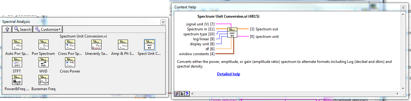

Spectrum Unit Conversion VI can be found in the LabVIEW palettes: Functions>>Signal Processing>>Spectral Analysis

The block diagram screenshot above is a VI snippet. Save the *.png to your computer and then drag the file onto a block diagram in LV 2012.
