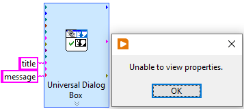

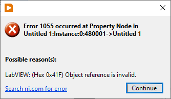

So, how is this thing used? I could not drop it on the BD, but I could insert it as a VI and apparently its an express VI. But I cannot open its properties and cannot run it (LV2021).
When run:
Must say I'm a bit reluctant to Express-VIs, but I'm still interested to see what your VI can do.

Same here. Thought i didn't wire something, so i wired everything, but the error still pops up (LV 2019).
I didn't install it tho, just dropped on block diagram.

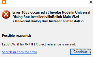

*Facepalm* I opened the README-file but I did not read it...

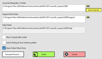

The installer completely hanged LV though. Tried installing again without mass-recompile and got:
Removed all installed files in user-lib. Tried opening install.vi again and it stays at 100% cpu for at least five minutes. killed LV and opened again. Now Install.vi can be opened. Tried installing again:
the folder <user.lib>\_express\UDB opens and LabVIEW is stuck in the taskbar with no displayed window and at 100% cpu for at least five minutes until I killed it.

I broke the configure functionality just before I zipped it up (just t minor error flow "improvement. D'oh).
The there's an error flow issue with the installer: If LV is not run as admin, the installer can't update the user.lib; instead of throwing a permissions error, and invalid reference error comes out.
I've fixed both of those, but found a couple more installer issues.

Does somebody want to help out?  Here are the remaining issues:
  • In "Universal Dialog Box\Intstaller\Support\Place on Palette.vi", the call to "Write Palette.vi" fails.
  • In "Universal Dialog Box\Intstaller\Install.vi", If LV isn't running as admin, and you've clicked on paul_cardinale_0-1642865977081.pngpaul_cardinale_0-1642865977081.png, then when you install, error 8 gets thrown right away.  I'd like it to check permissions whenever a folder is changed, and show a warning of some kind.  But paul_cardinale_1-1642866197596.pngpaul_cardinale_1-1642866197596.png returns binary 111111111 on the folder even though it's not writeable.  What's the cleanest way to check that (or to check whether running as admin)?
  • When you do install to user.lib, it doesn't update "... \user.lib\dir.mnu".  Has anyone got a piece of code on hand to do that?
