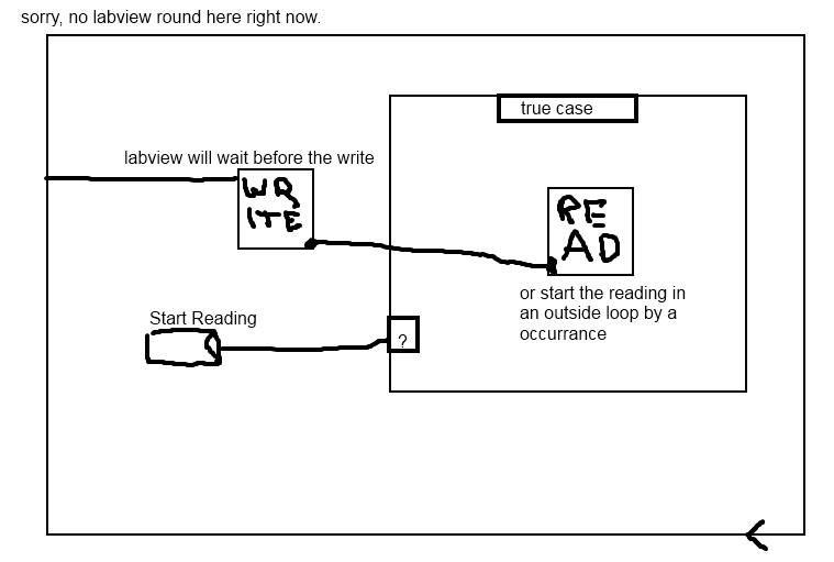

"I'd need to make that loop iterate once every millisecond to achieve the accuracy I need, correct?"
No, because the write command doesn't take 100ms. It only needs  a short time, then the loop loops and waits before the write command can start again (trggered by the reading hardware).
So the limitation is, that you only have 10 possible but quite exact Starting Points per Second.
But I thought it would not matter because it is started by hand anyways.
It would be a rather simple solution. But if it is 1ms exact..... With additional timing hardware you can, of course, do better.
Oh, and you have to initialize the reading before your trigger because the init would take too long.
