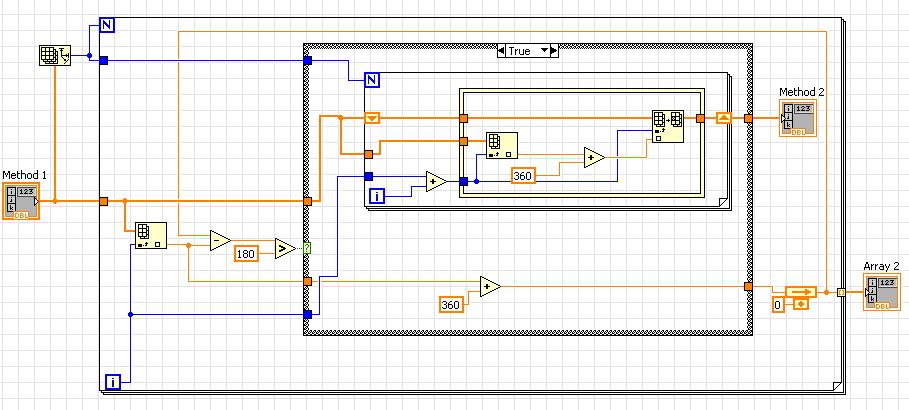

Hi all,
I have a problem with updating array elements and use these elements again. Okay, let me make the idea clearer. I have an one dimensional array of double. Now I am just comparing two adjacent elements. If the difference is bigger than a threshold, I need to update all the remaining elements (for instance, add 100 with all the remaining elements). And then repeat the whole things until all the elements are comparedI tried in the following way. But I am not quite sure how I use the updated array "Method 2" instead of "Method 1" in the next loop. The "In Place Element Structure" didn't help.
I know it is pretty simple in C++, where we can use the reference of the array. I am new in labview, and don't know how to do it here in labview
Seeking your help
BR//
Rosen

Please attach the real VI, instead of a picture.
Obviously, you are new to LabVIEW and you're not familiar with most tools.
(For example, with the "in place element structure" you would need to add "array index/replace element" terminals, eliminating most of the stuff currently in there.)
I think the entire thing can be done in one simple autoindexing FOR loop with code the size of a postage stamp.

Hi Altenbach,
Thanks for your prompt response. I got ur logic, but it's not that what I mean. I couldn't make it clear. I am trying again.
Do
   1. Compare two adjacent elements
   2. if the difference is bigger than threshhold (180)
            Add 360 with all the remaining elements.
while all the elements are not finished.
Means, if there is a certain difference, it will change the remaining array elements and than start comparing with this modifyed array elements. Not adding multiple incremental numbers. I think , you get the point. Please find the attachement for sample data. Waiting for your reply.
