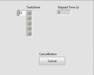

Knowing the interface is extremely simple and won't do complex tasks, it look like this :

Hi Martial,
learn about using queues and notifier (or wire channels), then place "process" and "HMI" into their own loops…
(2,533 Views)
I would like to also add User Events to this list.  I use User Events to pass data from the process loops to the HMI loop (which is mostly an Event Structure already).
