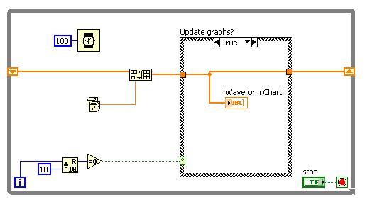

This is a bare-bones and simple way of doing what you suggest.
Never say "Oops." Always say "Ah, interesting!"
