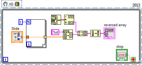

My problem is, as I update my data (the slider) the old data gets rewritten into the array. i wish to store all the data points with the real time at which the new data got entered into an array, or perhaps a spreadsheet. I would like to export this spreadsheet into an Excel file that displays ALL data that has ever been recorded with the time( and date if possible) associated with it.

  • What's the purpose of the FOR loop?
  • What do you mean by "real time".
  • Why are you formatting floating point values with an integer format (%d)?
  • What determines the loop rate. (Currently you would run quickly out of memory if you would accumulate the data in a shift register.)
Just open a file for writing before the loop, append new data pairs inside the loop until stop is pressed, the close the file.

- For loop is just to represent a 1D array.
-Real time as in I want to also record the time/date of when the new data has been entered
In this VI that I have attached, i generate a spreadsheet looping table. After 10 data entries, the previous data gets deleted and the new data gets recorded simutaineously. Somethign like this is preferred. For example I would liek to record 100 of the recent data entries.
A 1D array with one element. Does not seem to make a difference here.
So why don't you use it? All you need ot do is change a diagram costant. Why is the table a "control" if you actualy use it as an indicator? Change it to an indicator and get rid of the local variable.
How often would you like to save to a file? Do you want to only keep the last 100 entries in the file or should the file grow forever?
