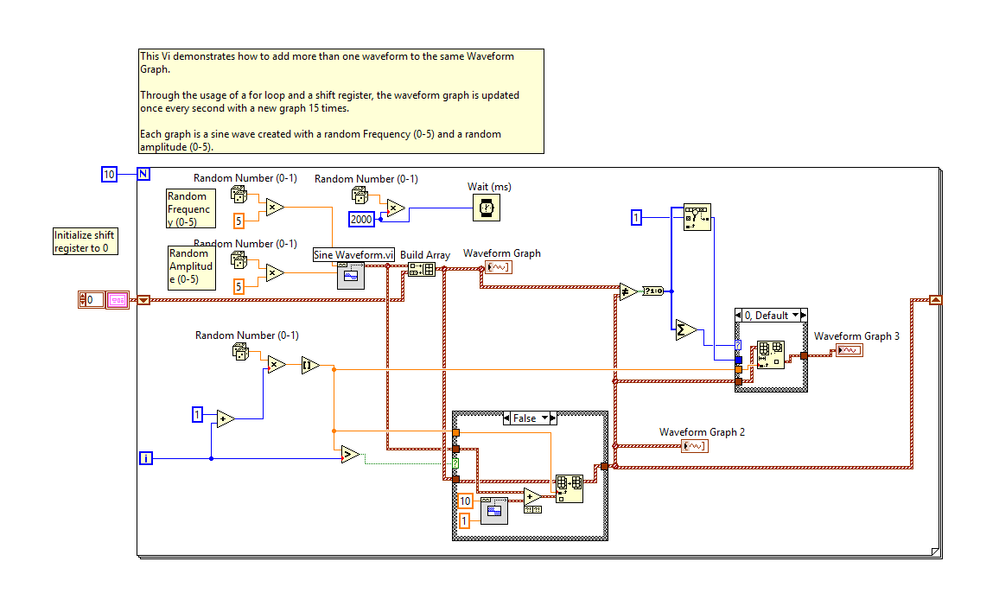

Dear GerdW,
@GerdW wrote:
3. Do you have problems with a specific VI? Then attach that VI!
The attached file is my VI for the problem. In this VI, an array of waveform is created through a FOR loop. In each iteration, another waveform is created and added or summed to a random waveform in the array.
I want the Waveform Graph 2 presents only the last updated waveform instead of all waveforms in the array.
Thank you so much!
Micheal
Message 5 of 13
(4,230 Views)

Hi Micheal,
just wire the "last changed" waveform to your graph:
Message 8 of 13

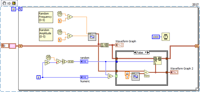

Dear GerdW,
@GerdW
I have a solution for this problem:
Firstly, compare the stored waveform array with the newly updated array to find the index of changed waveform. Then extract the corresponding waveform from the new array to get the last updated waveform.
I think, because in my VI, the new waveform is created from an old waveform so we can know what and where the newly updated waveform is in advanced. That makes the problem seem to be trivial.
In fact, my "original" problem is a little different. The new data is not created from the old data, so I don't have "thing" to compare to extract the last updated one like this. Please see the attached file for my "original" problem.
Thank you so much!
Micheal
Message 9 of 13
(4,207 Views)
Hi Micheal,
Which is overly complicated!
- Why do you need to search for the changed array element when you already know which one gets replaced/changed in the case structure???
- Why do you need to convert the boolean array to an integer array? You can also search a boolean array for a TRUE constant!!!
In your "original" problem you also know which part of your array gets changed: you calculate a (random) position in the left part of your while loop…
