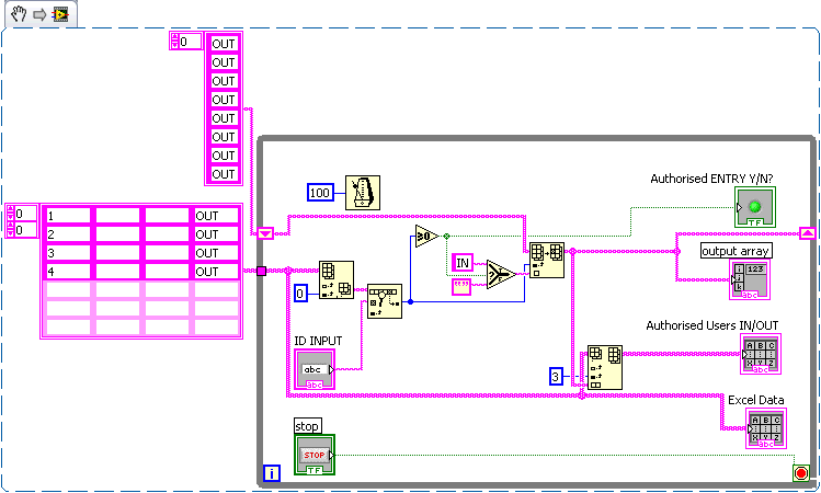

I am importing a table of 'authorised users' from excel into a LV table.
When a user inputs his ID he becomes booked 'out' or 'in' if authorised on the LABVIEW table
This booking in/out table then gets saved to a different excel spreadsheet
The problem I have is if one person 'A' books out followed by person 'B', person 'A' gets booked back in automatically.
Could anybody please assist? I can't seem to find any similar examples for guidance.
I have attached a copy of my attempts, if this help.  Thankyou
My LV version is 8.5
Message 7 of 9
(5,487 Views)
If you replace the tunnel for your 1D array of 'OUT' with a shift register, it will store your changes.  I removed your file reading and writing, but you should get the idea.
Message 8 of 9
(5,468 Views)
Many thanks, that works a treat although now encountered  a smaller problem.  When booked 'IN', unless I stop the program  and re-start they can't be booked back 'OUT', although I am now looking into this!!
Once again thankyou for your help
